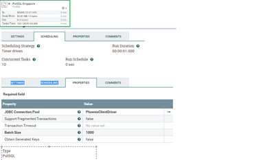

Rising Star
1. we are using UPSERT commad only in phoenix .
2. even i am unable insert 100/sec
3 . PFA of PutSQL configuration
I am getting 10,000 records per second . but i am able to insert only 20-50 records per second . queue is not getting piled up , looks data loss is happening . please let me know how to improve performace .atleadt 1000/sec as said.
and how to debug/test whether the data loss is happening or not . thanks in advance .

Based on your screenshot, you are writing no data via this processor (Out is 0bytes). I would recommend you verify that Phoenix and HBase are healthy before trying to introduce NiFi into the picture.

@Josh Elser @srinivas padala
The "Read/Write" stats on the processor have nothing to do with writing to your SQL end-point. This particular stat is all about reads from and writes to the NIFi content Repository. This helps identify where in your flow you may have disk high disk I/O in the form of either reads or more expensive writes.
From the screenshot above, I see that this processor brought in off inbound connections 35,655 FlowFiles in the past 5 minutes. It read 20.87 MB of content from the content repository in that same timeframe. The processor then output 0 FlowFiles to any outbound connection (This indicates all files where either routed to a an auto-terminated relationship). Assuming only the "success" relationship was auto-terminated, all data was sent successfully. If the "failure" relationship (which should not be auto-terminated here) is routed to another processor, the 0 "out" indicates that in the past 5 minutes 0 files failed. The Tasks shows a cumulative total CPU usage reported over the past 5 minutes. A high "Time" value indicates a cpu intensive processor.
