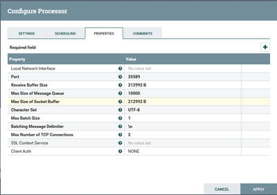

I am unable to get TCP nifi to nifi to work.
I have a put TCP processor that puts files to a port and host, but when the receiving host receives the TCP via listen TCP it receives a TON of small files that are not the original flowfile.
Is listen TCP not putting the packets back together into a flowfile? or am I doing something wrong here?

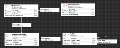

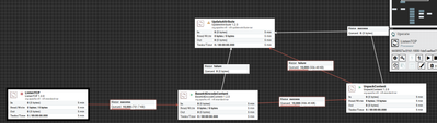

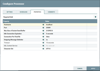

Attached are pics of my configs and setup.

The GenerateFlowFile processor is capable of creating multi-line content in a FlowFile. Even after passing that content through the Base64EncodeContent Processor the content will remain multi-lined.
The putTCP processor is then pushing the multi-line content in to the internal socket buffer of the ListenTCP processor. The ListenTCP processor will then read those lines and create new FlowFiles in which they will be placed based on the configured batch size. In your case you have a batch size of only 1, so each created FlowFile will only contain a single line each. This would explain why you see so many little FlowFIles being generated on your receiving side.
