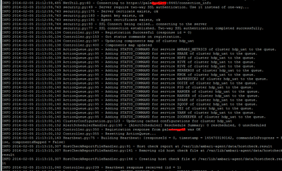

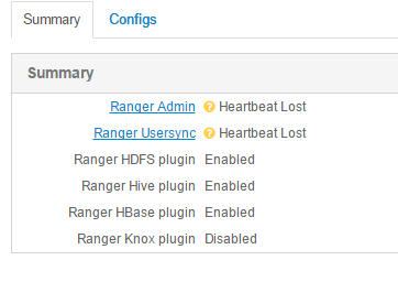

there is a strange situation within Ambari (v2.0.1) where Ranger suddenly lost the connectivity, since Ambari shows "Heartbeat lost" for Ranger-admin/-usersync.
The node where Ranger is/should run is fine, since it is the same as Ambari is running itself.

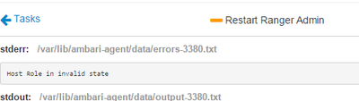

Trying to restart Ranger results in the following =>

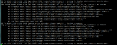

and the corresponding log entries of ambari-server:
What the hell has happened here ?!?!

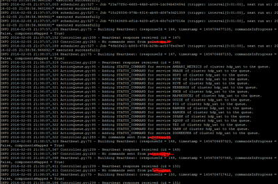

Hi @Neeraj Sabharwal , unfortunately not, still the same situation. Log excerpt from ambari-agent:
It is going to be late, maybe I can't see the forest but the trees ?!?! 😉

ambari-agent.log:
ambari-server.log (not that much entries after starting ranger-admin):
