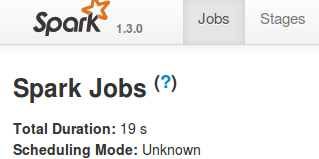

Exception in thread "main" java.net.ConnectException: Call From m4040/192.168.88.46 to 0.0.0.0:8032 failed on connection exception: java.net.ConnectException: Connection refused; For more details see:  http://wiki.apache.org/hadoop/ConnectionRefused
On batch and speed web page, it showed like this:
I guess my laptop could not communicate with kafka on cluster and this oryx job was rejected by yarn ?!
Master Collaborator
You can run the binaries on any machine that can see the Hadoop configuration on the classpath, and which can access all of the services it needs to in the cluster. There are a number of services to talk to: HDFS, YARN, Kafka, Spark and the app's executors. So in general you'd have to have a lot of ports open, and at that point your machine is effectively a gateway node in the cluster. Certainly it's meant to be run within the cluster.
The serving layer only needs access to Kafka, and that's by design, so it might more easily run outside the cluster.
