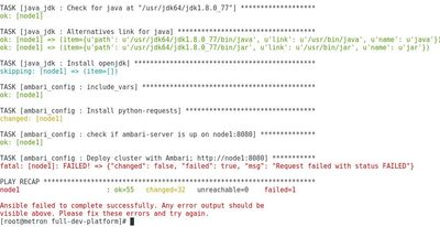

Trying to deploy Apache Metron on single node VM, but Ansible and maven dependency failures, please help I am stuck
New Member
Hi,
I am trying to deploy Apache Metron on a single node VM, but after vagrant up, when I run vagrant provision, it gives me errors on maven dependencies and ansible failed to setup successfully.
I have installed all packages defined for Metron deployment, Ansible 2.0.0.2, Vagrant 1.9.6, Maven 3.3.9, Virtual Box 5.1.30 JDK 1.8 and Python 2.7.5
Also, when I run the command "mvn clean package", metron-config error pops up and it doesnt complete its installation, followed by metron-rest, metron-rest client

Please click on the link as highlighted below.... to see the service logs
Also, from your 2nd screenshot I can see that there was a timeout because of which the script was killed. This could be due to resource constraints on your system. I would recommend that you find a system with a better configuration and try deploying Metron there.

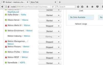

New Member
@asubramanian
What happens after this step? I see a big lag from here, and I have allocated 13 GB RAM for my VM 42792-capture42.jpg
Super Collaborator
This is where the crux of the whole deployment happens - Ambari first installs all the services, and then starts them.
New Member
42793-capture43.jpg@asubramanian
My system fails to deploy metron , why does this happen?
