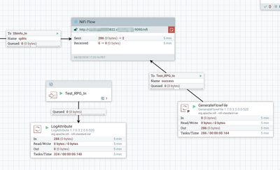

Attachment 1 shows Test flow. RPG url is set to node xxx22, one of the worker nodes

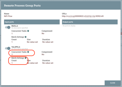

Attachment 2 shows settings for the test input port (Concurrent tasks 7, Batch Settings count 1)

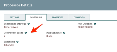

Attachment 3 shows Concurrent tasks of receiving process (not sure this matters, but I was desparate!)
