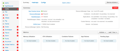

Now i checked and i found from ambari gui that my resource manager is also not working.
