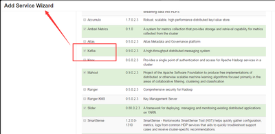

I used the ams rest api to remove some unused service like kafka.
First, I stop the service via ams ui
Secode, i run the command curl -u admin:password -H "X-Requested-By: ambari" -X DELETE http://ams_host:8080/api/v1/clusters/mycluster_name/services/KAFK

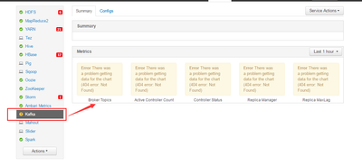

I removed it successed, but the ambari ui has a 'unknow' state
and i can't install kafka componment anymore, because it is installed in "Add Service Wizard", I can not do anything about kafka right now

Can you please start and stop the ambari-server and ambari-agent where kafka is running and also form ambari DB check the hostcomponentstate table and look for the status of KAFKA service if it is still found in this table then start the ambari-agent and server and run the Delete command once again, it should help with the issue.
If not please let me know the error you are getting.

I know the issue now, it's because the table in DB has been broken
so it can't not work well
