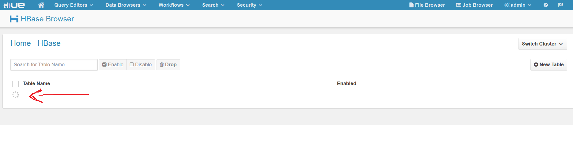

creat hbase table using hue
helllo
i cann't create or list tabled in Hbase via hue
kerberos is enabled and configerd in my cluster
any one can hellp me ?

sorry  ,
i found this error in hue error log file
#tail -f /var/log/hue/error.log
[09/Feb/2015 08:27:48 -0800] kerberos_    ERROR    handle_other(): Mutual authentication unavailable on 200 response
[09/Feb/2015 08:28:18 -0800] kerberos_    ERROR    handle_other(): Mutual authentication unavailable on 200 response
[09/Feb/2015 08:28:48 -0800] kerberos_    ERROR    handle_other(): Mutual authentication unavailable on 200 response
[09/Feb/2015 08:29:18 -0800] kerberos_    ERROR    handle_other(): Mutual authentication unavailable on 200 response
[09/Feb/2015 08:29:48 -0800] kerberos_    ERROR    handle_other(): Mutual authentication unavailable on 200 response
[09/Feb/2015 08:30:18 -0800] kerberos_    ERROR    handle_other(): Mutual authentication unavailable on 200 response
[09/Feb/2015 08:30:48 -0800] kerberos_    ERROR    handle_other(): Mutual authentication unavailable on 200 response
[09/Feb/2015 21:29:38 -0800] kerberos_    ERROR    handle_other(): Mutual authentication unavailable on 200 response
[09/Feb/2015 21:30:06 -0800] kerberos_    ERROR    handle_other(): Mutual authentication unavailable on 200 response
[09/Feb/2015 21:30:37 -0800] kerberos_    ERROR    handle_other(): Mutual authentication unavailable on 200 response
[09/Feb/2015 21:31:07 -0800] kerberos_    ERROR    handle_other(): Mutual authentication unavailable on 200 response
[09/Feb/2015 21:31:37 -0800] kerberos_    ERROR    handle_other(): Mutual authentication unavailable on 200 response

its work
thank you
