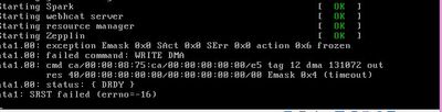

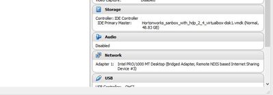

first , i tried "host only adapter" by seeing community hortonworks article . could not able to open hdp welcome page and 8080(ambari).
after, i tried using "bridge network" , got below error .
can you tell what mistake i have done?

In sandbox NAT should be used. See this https://community.hortonworks.com/questions/23453/yum-install-doesnt-work-couldnt-resolve-host-mirro...
