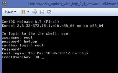

I have the same problem. First I logged on to the sandbox and have to change the default password "hadoop" to my preferred on. Logon is possible:

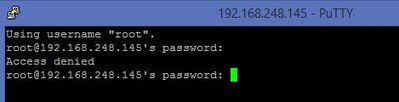

Also not possible via putty port 22:
ssh in the sandbox is possible:

ok found that I my used password containing an underscore is the problem (code translation?).
