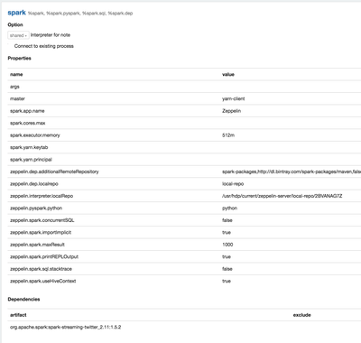

Created on 10-23-2016 02:03 PM - edited 08-18-2019 06:28 AM
Try loading https://mvnrepository.com/artifact/org.apache.spark/spark-streaming-twitter_2.11/1.5.2 under spark interpreter as a dependency

Created 10-24-2016 08:36 AM
Created 03-02-2017 08:34 AM
