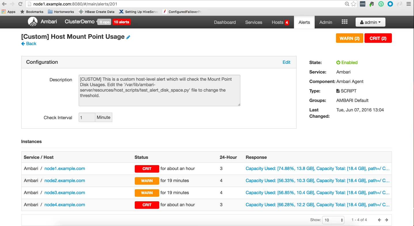

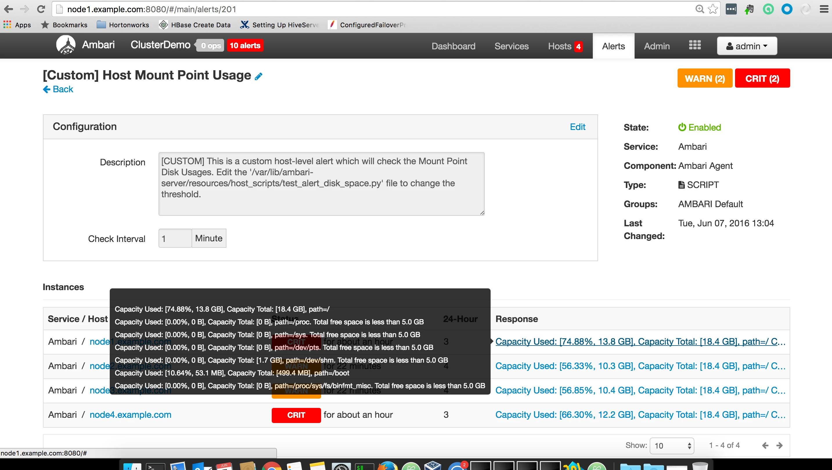

We should be able to see the following kind of alerts based on the the should we have set:
List of every mount point and it's disk usage percentage.
