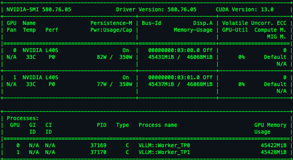

nvidia-smi command will show the below like output with actual memory usage after loading the model into both of the available GPUs:
nvidia-smi output after deploying Meta-Llama-3.1–70B-Instruct-AWQ-INT4 model

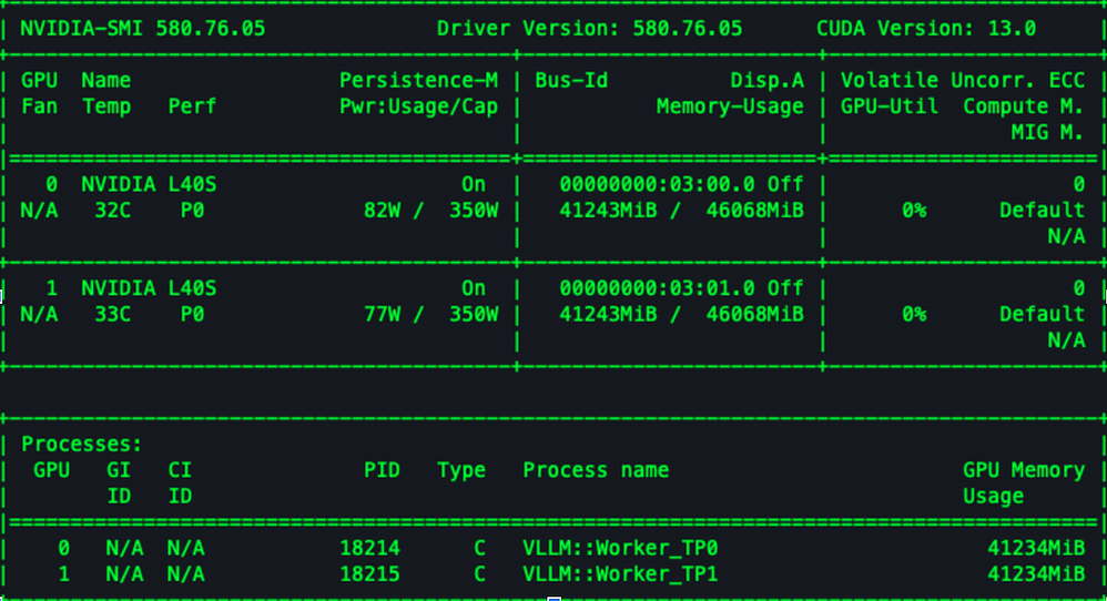

Below is the nvidia-smi output:
nvidia-smi output after deploying gpt-oss-20B model
nvidia-smi shows a slightly higher memory footprint for the gpt-oss-20b model due to the increased max-model-len parameter, which is set to 16384 compared to 8192 for the Meta-Llama-3.1–70B-Instruct-AWQ-INT4 model. This larger token limit necessitates more VRAM to accommodate longer sequences during inference.
