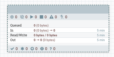

Once you have multi-user authentication and authorization setup, you'll need to authorize your users.  All users will access the same root Process Group (PG) which is the top level canvas.  It is then common for a unique child PG to be created  for each unique user or group.  You can not hide components on the canvas, this is done to prevent one user/group from building their dataflows on top of other user's dataflows.  However, if a user/group is not authorized on a PG, they will only see a dashed outlined PG box and no details.  Same goes for processor  and other components.

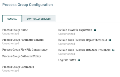

And if they try to view the configuration they will not be able to see that either:
