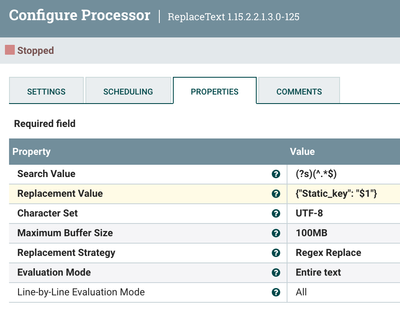

@KhASQ ,
Besides @SAMSAL solution, you can also use ReplaceText to eliminate the need of extracting the entire content as an attribute. You'd still have to set a large enough buffer, though, to ensure your largest message could be processed.
Cheers,
André
