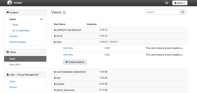

You can try below steps -
1. Login to ambari
2. Click on "admin" dropdown ->Manage Ambari -> click on "Views"-Add new view or you can check configuration for existing view.
Pls find below screenshot -

I looked at the options for configuring existing views but I don't think this will fix the issue, as I think it is an HDFS connection/installation problem and not just a UI issue do to the errors.
Unless you have an idea for configuration that could fix the "cluster's connection" and the hdfs recognition.
