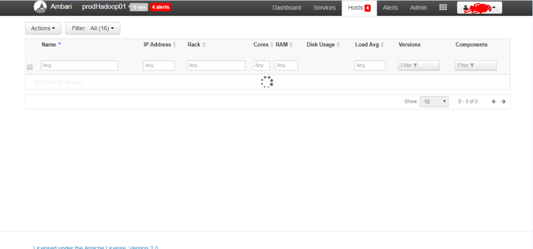

Hi, we are using ambari 2.2.2.0 and we are unable to see the hosts when i click on hosts tab on the ambari UI. it loads forever or it says no hosts available. I have restarted ambari server and ambari agents capture.pngbut no luck. Please guide me to fix this issue

If the "hosts" page is keep loading as seen in the "capture.png" screenshot then it means there is some inconsistency in the ambari DB. You must be getting some indication for the same inside your "/var/log/ambari-server/ambari-server.log". There must be some ERRORs/WARNINGs logged in the ambari server that will help us in finding the inconsistency.

capture.png . These are the errors i get when i look in to the ambari metrics. capture.png The error when i enable the developer tools in chrome. My ambari db is oracle database. I will have a look in to that and i will check hosts table meanwhile
