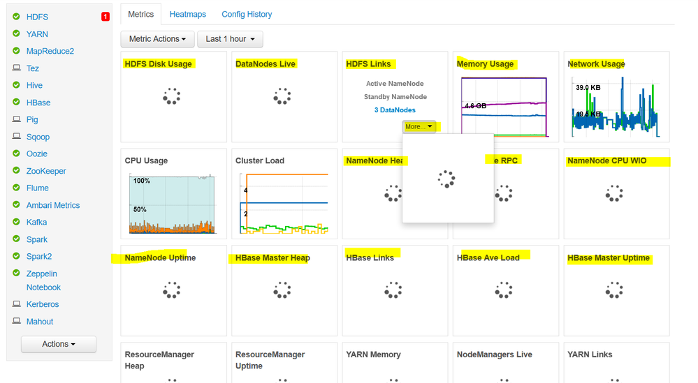

I Deployed a HA Kerberized HDP 2.6 Cluster, using Ambari 2.5.2.0 via its REST API, everething works fine but Ambari UI is not displaying some Widgets and Actions !! I can't either add a new component via its UI.

Have you also upgraded Ambari to 2.5.2 recently?
If yes then have you performed the Ambari Post Upgrade steps.... which includes upgrade AMS i see that the AMS related widgets are not showing data:

Hi @Jay SenSharma, No It's a fresh deployment !

@Amine Benatmane
If it is fresh installation then please check the NameNode/DataNode logs to see if you find that the "timeline Sink" service is started properly or not? And of from those NameNode/DataNode/Yarn hosts you are able to connect to the AMS collector host port as following:
# cd /var/log/hadoop/hdfs/
# find . -name "*.*" | xargs grep -i "Sink timeline started
If iInk timeline is not started then you might be seeing some Connection Refused error in the component (NN/DN/RM/NM logs) logs so please verify of they have the correct AMS host port information mentioned isnide their following file:
# grep 'timeline.collector' /etc/hadoop/conf/hadoop-metrics2.properties
# grep 'sink.timeline.port' /etc/hadoop/conf/hadoop-metrics2.properties
Please try to ping that host & port form the component (NN/DN/RM/NM) hosts like:
# nc -v $AMS_HOST  6188
(OR)
# telnet $AMS_HOST  6188<br>
Also please check and share the "/var/log/ambari-metrics-collector/ambari-metrics-collector.log" to se eif there are any WARNING / ERROR mentioned.
Also please check if the "/usr/lib/ambari-metrics-hadoop-sink/ambari-metrics-hadoop-sink-with-common*.jar" JAR is loaded by the components like NameNode / DataNode?
# lsof -p `cat /var/run/hadoop/hdfs/hadoop-hdfs-namenode.pid `  | grep metrics
# lsof -p `cat /var/run/hadoop/hdfs/hadoop-hdfs-datanode.pid`  | grep metrics
@Jay SenSharma
The "timeline Sink" service is started properly and the Connection to $AMS_HOST 6188 port [tcp/*] succeeded!
No Errors in /var/log/ambari-metrics-collector/ambari-metrics-collector.log yet !
/usr/lib/ambari-metrics-hadoop-sink/ambari-metrics-hadoop-sink-with-common-2.5.2.0.298.jar is loaded correctly by NameNode but not by DataNode !

/var/logs/ambari-server/ambari-server.log shows:
ERROR [ambari-client-thread-27] ReadHandler:102 - Caught a runtime exception executing a query java.lang.NullPointerException at org.apache.ambari.server.controller.internal.ResourceManagerHttpPropertyRequest.getConfigResourceManagerId(ResourceManagerHttpPropertyRequest.java:111) at org.apache.ambari.server.controller.internal.ResourceManagerHttpPropertyRequest.getPort(ResourceManagerHttpPropertyRequest.java:92) at org.apache.ambari.server.controller.internal.ResourceManagerHttpPropertyRequest.getUrl(ResourceManagerHttpPropertyRequest.java:77) at org.apache.ambari.server.controller.internal.HttpPropertyProvider.populateResource(HttpPropertyProvider.java:137) at org.apache.ambari.server.controller.internal.HttpPropertyProvider.populateResources(HttpPropertyProvider.java:121) at org.apache.ambari.server.controller.internal.ClusterControllerImpl.populateResources(ClusterControllerImpl.java:155)
31 oct. 2017 12:39:21,312 ERROR [ambari-client-thread-27] ContainerResponse:419 - The RuntimeException could not be mapped to a response, re-throwing to the HTTP container java.lang.NullPointerException at org.apache.ambari.server.controller.internal.ResourceManagerHttpPropertyRequest.getConfigResourceManagerId(ResourceManagerHttpPropertyRequest.java:111) at org.apache.ambari.server.controller.internal.ResourceManagerHttpPropertyRequest.getPort(ResourceManagerHttpPropertyRequest.java:92) at org.apache.ambari.server.controller.internal.ResourceManagerHttpPropertyRequest.getUrl(ResourceManagerHttpPropertyRequest.java:77) at org.apache.ambari.server.controller.internal.HttpPropertyProvider.populateResource(HttpPropertyProvider.java:137) at org.apache.ambari.server.controller.internal.HttpPropertyProvider.populateResources(HttpPropertyProvider.java:121) at org.apache.ambari.server.controller.internal.ClusterControllerImpl.populateResources(ClusterControllerImpl.java:155) at org.apache.ambari.server.api.query.QueryImpl.queryForSubResources(QueryImpl.java:500)
31 oct. 2017 12:39:21,315 WARN [ambari-client-thread-27] ServletHandler:561 - Error Processing URI: /api/v1/clusters/CLUSTER_NAME/components/ - (java.lang.NullPointerException) null
31 oct. 2017 12:39:21,461 INFO [ambari-client-thread-26] QuickLinkVisibilityControllerFactory:44 - No quick link profile is set, will display all quicklinks.
Master Mentor
@Amine Benatmane
I see two errors (Both are NullPointerException) in the logs: (One indicates Yarn Config issue and the other indicates indicates DB inconsistency)
1. This NullPointerException is coming from this API:
https://github.com/apache/ambari/blob/release-2.5.2/ambari-server/src/main/java/org/apache/ambari/se...
Which can happen only if somehow the "hostNameByID" is incorrect or the "hostname" variable is Null. OR if the "yarn.resourcemanager.ha.rm-ids" is not configured properly inside your "yarn-site.xml"
2. Following "NullPointerException" is more problematic as it indicates a DB Issue (Inconsistency). Which will require a complete review of the DB dump to findout why the conponents API is throwing Null.
@Jay Kumar SenSharma
yarn.resourcemanager.hostname.[RM_ID] was missing in yarn-site config, thanks a lot !
