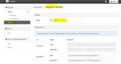

An internal system exception occurred: Stack HDP-2.4 doesn't have upgrade packages
Created 01-21-2018 02:47 AM
Issue resolved , performed below steps are worked me, after that i able register the target version on Ambari.
As we need to update the stack version , after ambari-server up-grade 1.6 to 2.+ .
https://ambari.apache.org/1.2.3/installing-hadoop-using-ambari/content/ambari-chap9-3.html
[root@server ~]# ambari-server upgradestack HDP-2.4 Using python /usr/bin/python Upgrading stack of ambari-server Ambari Server 'upgradestack' completed successfully. [root@server ~]# ambari-server start Using python /usr/bin/python Starting ambari-server Ambari Server running with administrator privileges. Organizing resource files at /var/lib/ambari-server/resources... Server PID at: /var/run/ambari-server/ambari-server.pid Server out at: /var/log/ambari-server/ambari-server.out Server log at: /var/log/ambari-server/ambari-server.log Waiting for server start.................... Ambari Server 'start' completed successfully. [root@server ~]#

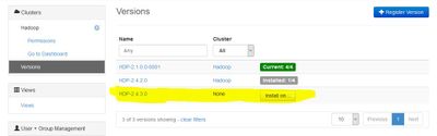

Created on 01-21-2018 01:01 PM - edited 08-17-2019 11:45 PM
After Fix Repository
