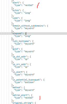

I have already defined a elasticsearch index template with the two fields "metron_alert" and "alert"

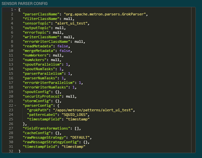

Here is the sensor information

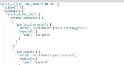

Below is the index template
when you run
GET alert_ui_test_*

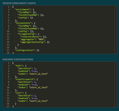

Below is the sensor and enrichment config
