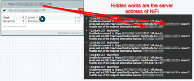

Hi,
I want to configure a Remote Process Group in my NiFi Flow, but I get a SSLPeerUnverifiedException. Do I have to configure a certificate for the RPG? How can I import the certificate for the RPG?

Master Mentor
@Jan
This error is telling you the hostname in the URL header does not match the owner or any Subject Alternative Names (SAN) in the server certificate being presented by the target server.
For example: You configure an RPG with a target NiFi URL of "https://nifiserver:9443/nifi". During the TLS handshake the server identifies itself based on the contents of its keystore as "nifiserver01.corp.com". The above error is thrown because it appears some other server is trying to pretend to be intended destination server "nifiserver".
NiFi's Site-to-SIte (S2S) capability uses the keystore and truststore configured in the nifi.properties file of both NiFi instances (Client side running RPG and server side running input/output ports) for the TLS handshake.
You will want to perform a verbose listing of the keystore file on your target Nifi and make sure the following are true:
1. The keystore contains only a single PrivateKeyEntry
2. The owner of that single PrivateKeyEntry has a CN value or a SAN entry that matches the hostname of that server.
Then make sure that you are using either the owner CN or one of the SAN entries in the URL used in your client side RPG.

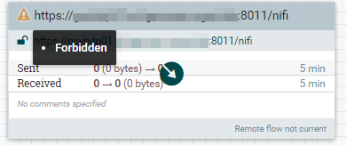

thank you @Matt Clarke! Now it seems to be working, but the RPG throws another exception:
Do I need to create a specific user and set the policy "retrieve data via site-to-site" in the Input Port of the nifi flow?
Master Mentor
@Jan
Can we keep each post in community.hortonworks.com to a single question? The above is no longer an TLS handshake issue. It is an authorization issue. Please start a new question for this topic.
