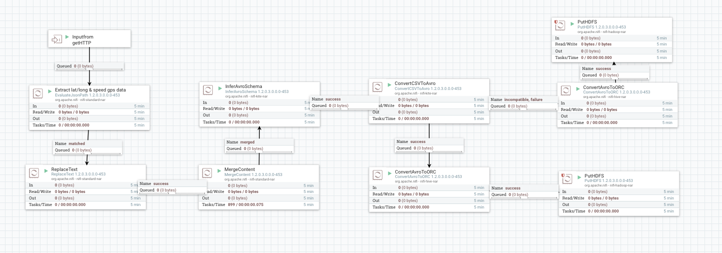

Hi Matt, this happens randomly, within my sample data set i ran it mutiple times, every time this fails at a different point. Interesting thing is, when i change the number of bins to 1, then it does not any merge at all, when i remove merge content processor its absolutely fine. screen-shot-2017-10-18-at-52930-pm.pngscreen-shot-2017-10-18-at-53030-pm.png

Matt, Thanks for helping me with this. The real problem was with InferAvroSchema processor as it uses Kite to determine the data type of the record. if you have nulls or zeros as a record value, this inferAvroSchema is not consistent, and during a merge if a bin consists of some data of double or float data type, and some zeros, ConvertJSONtoAVRO fails as the schema inferred in incorrect. It would be wise to configure the schema manually in the ConvertJSONtoAVRO schema instead of using InferAvroSchema, if that makes sense..
