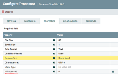

1- After getting the input, use UpdateAttribute to set the isProcessed flag to 0

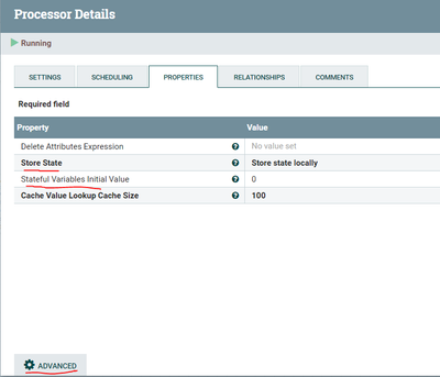

2- Use another UpdateAttribute where Store State is set to "Store State Locally". This processor will be used to define rules that will increment\decrement flowfileCounter based on the isProcessed flag as follows:
    - isProcessed = 0 and flowfileCounter <  2 then flowfileCounter +=1
    - isProcessed = 1 then flowfileCounter-=1
 make sure to set the "Stateful Variables Initial Value"  to 0 to initialize your counter. since it starts from 0 then 2ed flowfile will be increment the counter to 1 hence <2

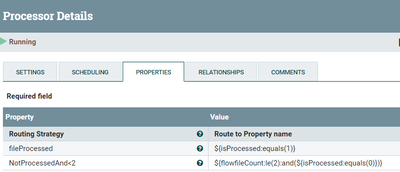

3- Using RouteOnAttribute create two conditional relationship:
    - ProcessedRel : check if the isProcessed flag is set to 1 . This basically will route to end of the flow. You can terminate if no farther processing is needed.
  - NotProcessedAnd<2 : this will check if the flowfileCounter is less than 2 and flowfile isProcessed is set to 0 to which if true then flowfile will proceed to be processed.
If none of the above condition is met, then you can use unmatched rel to loop back to the UpdateAttribute in step 2.

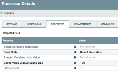

4- Once flowfile are processed use another UpdateAttribute to set the isProcessed flag to 1 and then point the success rel back to UpdateAttribute in step 2 to decrement the counter based on the defined rules.

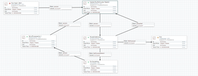

Here how my flow looks like:
GenerateFlowFile: is to simulate creating the input and set the isProcessed flag to 0 on each flowfile (step 1 above)

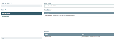

Update flowfileCounter stateful (UpdateAttribute - step2):  used to define the rules for setting the stateful flowfileCounter:
click Advanced to define Rules & Actions:

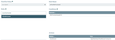

Rule1 \ Action 1: Increment flowfileCounter if flowfile not processed and less than threshold
Rule2 \ Action 2: decrement flowfileCounter if flowfile is processed
RouteOnAttribute : Proceed if flowfile is not processed and threshold < 2 . Finish if is Processed set to 1, otherwise loop back to step 2
Do Something (ControlRate): this is just to simulate doing something with the flowfiles from the NotProcessedAnd<2 rel above. This where you process the next two flowfiles.
Set isProcessed to 1 (UpdateAttribute -step 4):  set the isProcessed flag to 1 and point the success rel back to UpdateAttribute step 2 to decrement the flowfile counter user Rule2.

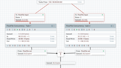

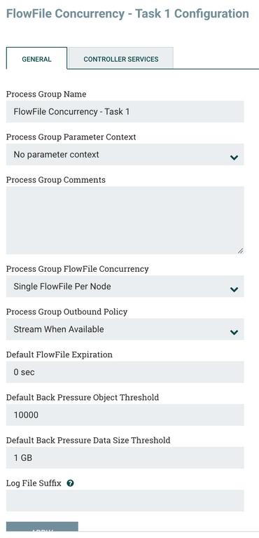

You may also want to take a look at Process Group (PG) FlowFile Concurrency configuration options as a possible design path since there does not  appear to be any dependency between task 1 and task 2 in your description.
You just want to make sure that not more than 2 tasks are executing concurrently. You move your processors that handle the 2 task executions inside two different child PGs configured with "Single FlowFile per Node" Process Group FlowFile Concurrency.  Within the PG you create an input port and output port.  Between these two ports you handle your task dataflow.  Outside this PG (parent PG level), you handle the triggering FlowFiles.   The task PGs will allow 1 FlowFile at a time to enter that PG and because of the FlowFile Concurrency setting, not allow any more FlowFiles to enter this PG until that FlowFile processes out.
As you can see from above example, each task PG is only processing a single FlowFile at a time.  I built this example so that task 2 always takes longer, so you see that task 1 Pg is outputting more FlowFile processed the Task 2 PG while still making sure that on two tasks are ever being executed concurrently.
