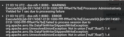

Using the ExecuteSQL processor (nifi 1.3) to fetch table from Teradata Database. The processor gives error (org.apache.avro.unresolvedUnionException: not in union ["null","float"]) when the table in the Teradata database has the 'Float' datatype.

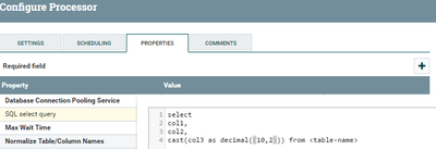

To resolve this error find out the column/columns which are causing issues
1. Cast those column/columns
2. Use the whole cast select query in ExecuteSQL processor.
instead of
select * from <table-name>
Use the Cast Select statement
select col1,col2,cast(col3 as decimal((n,m))) from <table-name> //give values for n(is the total number of digits (precision)) and m(is the number of digits to the right of the decimal point (scale).
Ex:- decimal(10,2) //total number of digit is 10, 2 digits to right of decimal point.
(or)
select col1,col2,cast(col3 as varchar(n)) from <table-name> //if you are not sure with decimal values then cast as varchar specify value for n(varying-length column of length n).
Ex:- varchar(30),varchar(20)...
Executesql Configs:-

According to this, it looks like Teradata doesn't support the DOUBLE data type, and instead supports FLOAT as the JDBC type yet returns a Double object when getObject is called. When the Double is inserted into an Avro record whose field type is "float", you get the above error.
This IMO is an issue with Teradata being out of spec with JDBC. Although NiFi could demote a Double into a float field, that is not prudent as there can be data/precision loss or other issues of which the user would never be made aware.
A workaround might be to use a DECIMAL column instead of DOUBLE, or to cast the column(s) as @Shu suggested.
