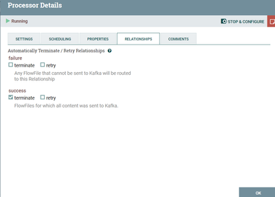

I tried using inbuilt retry mechanism of nifi processor
But still the issue is not resolved, publish kafka processor not forwarding flow files in failure relationship in case of error.

Are you seeing same behavior even when not using retry strategy of "yield"?
What about when retry is not checked?  FlowFiles, upon failure, should immediately be transferred to the connection containing the failure relationship.

If retry is not checked then similar behavior like yield is observed 5*numberOfIncomingFlowFiles secs to route to failure relationship as shown in photos.
