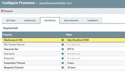

Here is the configuration I have in the processor:

The address you're trying to hit is "localhost". By any chance are you running ES in a Docker container on your machine? If so, have you exposed that port so that systems outside your own can access it? If you have, try changing localhost to your machines IP address in your NiFi ES processor config.

Thanks for your response. Now the problem is solved!
I was not able to connect due to that nifi was effectively installed in a docker in my computer, so, even the computer had access to the mongo database, the docker not.
Now I solved the problem and can continue working on it! Thanks again!
