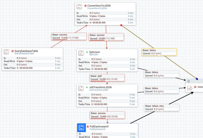

I tried to get some data from PostgreSQL and index them with elasticsearch.
After converAvroToJSON i got a JSON array like this,
  "gid" : 95167,
  "lat" : -0.5930874275427621,
  "lon" : 48.9348884422244
  "gid" : 95235,
  "lat" : -0.9967898987193282,
  "lon" : 48.935096381156605
  "gid" : 95307,
  "lat" : -0.7477345135642162,
  "lon" : 48.92913514241155
In order to use PutElasticsearch(HTTP) and geometry, i spited them and rebuild a JSON file. To splitJson and transformJSON takes a lot of time, so i want to remove splitJSON processor in order to speed up all the processor, but i cant .. Do you have some ideas ?
After JoltTransformJSON, the format likes that.
  "gid" : 799092,
  "coordinates" : [ 6.933880894889725, 48.0070784663541 ]
I need some help to improve the time of executing. I tried to index an array of data into elasticSearch, but i got an exception of index. It means that using the product of ConverAvroToJson processor and put them into ElasticSearch processor.
After some try the jetty serveur is down, i have changed JVM memory to 4096 mb and restarted the nifi, some data is locked between 2 processor ... how can i get them ? Web UI cant work.
I have read https://community.hortonworks.com/questions/31099/is-it-possible-to-to-perform-bulk-insert-to-es-wit...,
I dont want to use split, because it takes lots of time.
Thanks for you.

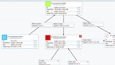

→I have tried use ElasticSearchHttp processor, in ArvoToJson processor I tried both none/array for json container options. If I don't do that I will get an exceptionlike that.
Were you pushing documents/data to the wrong index with an incorrect mapping?
→ no, because I use httpelasticsearch processor to index the splited data using the same mapping.
Posting the error from ES will help.
ERROR [Timer-Driven Process Thread-8] o.a.n.p.e.PutElasticsearchHttp PutElasticsearchHttp[id=0159101b-95cc-1764-e634-d90d6b5877ad] Failed to insert StandardFlowFileRecord[uuid=b1f52deb-bd58-4a8c-82dc-7378f0cd3660,claim=StandardContentClaim [resourceClaim=StandardResourceClaim[id=1482315336809-525, container=default, section=525], offset=883475, length=51862],offset=0,name=18050202000067,size=51862] into Elasticsearch due to , transferring to failure
MapperParsingException[failed to parse]; nested: IllegalArgumentException[Malformed content, found extra data after parsing: START_OBJECT];

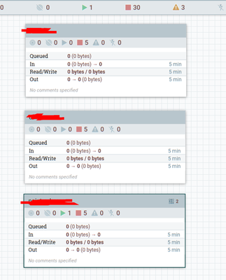

I created 3 processor group, one of them doesn’t work, when I start it, it doesn't work and the group cant be stopped..
There is 2 in red, i can't do use this processor, i waited 1 h for it ..
I put a video for you.
Failed to load resource: the server responded with a status of 409 (Conflict)

2016-12-21 14:13:51,059 ERROR [Timer-Driven Process Thread-3] o.a.n.p.standard.QueryDatabaseTable QueryDatabaseTable[id=01591001-75cd-17d5-dca1-8bf6e638af98] Unable to execute SQL select query SELECT gid,concat_ws(',',ST_Y(ST_SetSRID(geom_wgs84::geometry,4326)),ST_X(ST_SetSRID(geom_wgs84::geometry,4326))) AS coordinates,id,id_tr,numero,rep,nom_voie,nom_long_voie,code_insee,code_post,type_loc,cote FROM bdadresse.point_adresse due to org.postgresql.util.PSQLException: ERREUR: annulation de la requête à la demande de l'utilisateur: org.postgresql.util.PSQLException: ERREUR: annulation de la requête à la demande de l'utilisateur
2016-12-21 14:13:51,061 ERROR [Timer-Driven Process Thread-3] o.a.n.p.standard.QueryDatabaseTable

2016-12-22 08:49:17,342 WARN [Timer-Driven Process Thread-4] o.a.n.p.standard.QueryDatabaseTable QueryDatabaseTable[id=01591001-75cd-17d5-dca1-8bf6e638af98] Processor Administratively Yielded for 1 sec due to processing failure
2016-12-22 08:49:17,342 WARN [Timer-Driven Process Thread-4] o.a.n.c.t.ContinuallyRunProcessorTask Administratively Yielding QueryDatabaseTable[id=01591001-75cd-17d5-dca1-8bf6e638af98] due to uncaught Exception: java.lang.OutOfMemoryError: Java heap space
I have used arg5=5120M for jvm

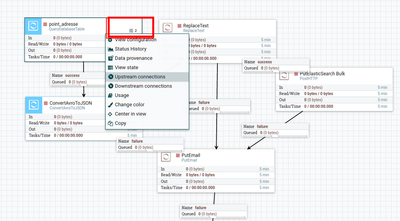

Would you mind sending a copy of the data that comes out of the "replaceText" processor? I would like to try on my local system to post to ES. Do you have the mapping for that index as well in ES? Is the data as simple as:
{  "gid" : 799092,  "coordinates" : [ 6.933880894889725, 48.0070784663541 ]},
{  "gid" : 799092,  "coordinates" : [ 6.933880894889725, 48.0070784663541 ]},{  "gid" : 799092,  "coordinates" : [ 6.933880894889725, 48.0070784663541 ]}
It looks to me like you should be using just the PutElasticSearch processor which uses the bulk api. I see in your "PostHTTP" processor in your video that you are pushing out to the "_bulk" endpoint. Looking at your error log, it seems it is not formatted correctly when being indexed in ES: "Caused by: java.lang.IllegalArgumentException: Malformed content, found extra data after parsing: START_OBJECT"
Explorer
Thank you, sorry for late. I found why it doesn't work... because the query is too huge to execute. The QueryDatabaseTable processor has a problem, it will read all the data then i got an outofmemeory exception ...
Then i tried to modifier GereateTableFetch to add a where condition in order to using index in database not a offset 🙂 OFFSET is bad for skipping previous rows.
so it can generate sql like this
select xxx
From xxxxx
where 200000=>id
order by id
limit 200000
input files
{"gid": 49900, "coordinates": "44.5638145014092331,4.4830168699343016"}
{"gid": 49901, "coordinates": "44.5110194507808501,4.26131697875612936"}
after replaceText
{"index":{"_index":"point_adresse","_type":"default","_id": 650}}
{"gid":650, "coordinates": "46.3066856051698537,5.94381332350432334"}
{"index":{"_index":"point_adresse","_type":"default","_id": 651}}
{"gid":651, "coordinates": "46.2950964034383858,5.93722413905152013"}
there is a /n
mapping
    "mappings": {
      "default": {
         "_all": {
        "enabled": true
      "dynamic_templates": [
          "string_fields": {
            "match": "*",
            "match_mapping_type": "string",
            "mapping": {
              "type": "string",
              "index": "analyzed",
              "omit_norms": true,
              "fields": {
                "raw": {
                  "type": "string",
                  "index": "not_analyzed",
                  "ignore_above": 256
        "properties": {
          "coordinates": {
            "type": "geo_point"
          "gid": {
            "type": "string"
I think it's a problem of ESHTTP processor and processor SQL ...
