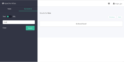

I cant get atlas to show any data using HDP 2.5 sandbox.
I have tried/checked the following things:
- Enabling: Amabari Infra, Kafka, HBase, Ranger, Atlas, Ranger Tag Sync service, HBase region server
- hive has data
- holger_gov can access the data in hive
But everytime i check atlas it says 'No Record found!'
Does anyone know how i can get this to work? Or a way to debug it? What logs could have relevant information?
Atlas application log: application.txt
Atlas application log after creating table and adding data: applicationaftertablecreation.txt
Hiveserver2 logs: hiveserver2.tar.gz
Thanks!

From the atlas application log, the metadata is consumed by atlas and everything looks fine..
2016-10-12 10:05:16,487 INFO - [NotificationHookConsumer thread-0:] ~ Updated entities: { "entities": { "updated": [ "52bf585a-8e66-4402-864a-84bc201daffc", "f67d81d9-4e2e-4396-99cf-2f2166e9fd83", "43c64fde-38c6-4dbc-b75e-86d804e619c0", "f5cdd132-0066-4a37-82a3-837d9316650d", "53015e6b-2588-4c3c-925b-1cc2596eebc5", "3ae5d014-147e-468d-a442-e4253d647fdc", "ae0dacc8-66ac-4c5f-8673-35a3d1ca678c", "fdc38fcc-edb9-48f6-a2f8-282a9032793a", "c33fc14c-7aeb-45cb-b933-8e3c3d9f5a6e", "52c78367-162c-4e91-b5f1-5335c8f2ad16", "59af504a-192c-4814-b657-80e3c3a5bb8b", "367ea90f-4bb7-4fc8-a43a-0fba1250cd29" ] } } (EntityResource:210)
Even the hive logs reflect the same.
Also, atlas.hook.hive.synchronous is setting used to publish messages at the user convenience(sync/async). In your case, even after setting atlas.hook.hive.synchronous to false, the metadata should have been published to atlas.
atlas.hook.hive.synchronous - boolean, true to run the hook synchronously. default false. Recommended to be set to false to avoid delays in hive query completion.

Glad that you tried resetting the property to check the actual issue.
I think the actual issue was, the way you tried to access the hive entities from UI. You could have tried DSL search like below.
