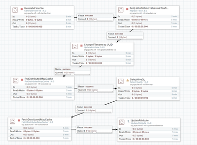

Sample Flow Example:-
i'm using GenerateFlowFile processor and adding 3 attributes to the flowfile
attr1
56
attr2
67
attr3
89

UpdateAttribute:-
We are using this processor to change the filename of flowfile to UUID because We cannot not refer to use UUID as cache identifier reason is output from SelectHiveQL processor is having same filename but different UUID(i.e until selecthiveq processor flowfile having one uniqueid after selecthiveql processor different uuid).**
Add new property as
filename
${UUID()}
PutDistributeCache processor:-
Configure DistributedMapCacheServer,DistributedMapCacheClientService and enable them(you need to change cache number of entriesas per your needs,persistence directory if not mentioned then all the entries will be stored in memory).
Cache Entry Identifier
${filename}
Now we have changed the flowfile content and cached the output content with the filename.
SelectHiveQL processor:-
Feed success relation to SelectHiveQL processor once the processor outputs flowfile with content of the flowfile then feed the success relationship to

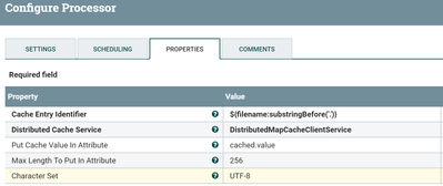

FetchDistributeCacheMap:-
Configs:-
${filename:substringBefore('.')} //because based on output ff format we are going to have .avro/.csv extensions
Distributed Cache Service
Put Cache Value In Attribute
cache_value //the cached content will be put in to this attribute instead putting into flowfile content
Max Length To Put In Attribute
256 //needs to change the value if max length is more than this value
Output:-
Flowfile will have attribute called cached.value then you can rebuild all your attributes by using getDelimitedField function
 ${cached.value:getDelimitedField(1, '|')} //will give attr1 field
Even without rebuilding all the attributes again by using above expression language you can directly pull the required attribute value and use them in your flow.
attr1
56
attr2
67
attr3
89

UpdateAttribute:-
Add new property as
filename
${UUID()}
${filename}
Configs:-
Output:-
