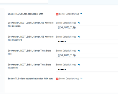

But when I enable Auto-TLS, services do not start. I've followed the documentation about Auto-TLS and restarted services in the correct order, but still the services complain about JKS files being missing in the process directory.
Certmanager is created properly by Auto-TLS and I see all host, global certs, JKS, truststore etc.
But when I start any service, the process directory (which is dynamically created), these JKS files are not created there. I'm unable to figure-out which configuration could be causing this. My cloudera-scm-server  / cloudera-scm-agent are healty after Auto-TLS restart.

For now, I've resolved this issue by replacing all CM_AUTO_TLS variables with actual paths for global truststore and keystore JKS files. Which means something is not working as documented in Auto-TLS and there some step/configuration needs to be done.
