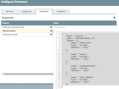

Try with the below Record Schema property
ConvertJSONToAvro Configs:-
Record schema
{ "type": "record", "name": "NifiHeartBeat_v3", "fields": [{ "name": "MeasureId", "type": "string", "default": "null" }, { "name": "Value", "type": "string", "default": "null" }, { "name": "AuditDateTime", "type": "string", "default": "null" }, { "name": "DATA_SOURCE", "type": "string", "default": "null" }] }And if you are testing with one json message then don’t enclose the whole json message in [](square brackets) because when we enclose the message in [] convertjsontoavro won’t parse the array message, we need to split the array if array having one message in it.
Try with json message
 "MeasureId": "nifiHeartBeat",
 "Value": "1",
 "AuditDateTime": "Tue Jan 16 13:48:58 CET 2018",
 "DATA_SOURCE": "20083"
}ConvertJSONToAvro configs:-

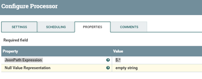

If you need to enclose message with [] then use split json processor to split the message
[{  "MeasureId":
"nifiHeartBeat",  "Value":
"1",  "AuditDateTime":
"Tue Jan 16 13:48:58 CET 2018",  "DATA_SOURCE":
"20083"}]SplitJson Configs:-
Because ConvertJSONtoAVRO processor won't parse array of json messages so we need to split them individually(even array having one message in it) and send to the processor.
1.Add the property value as
JsonPath Expression
Configs:-
Same configs as mentioned above.
