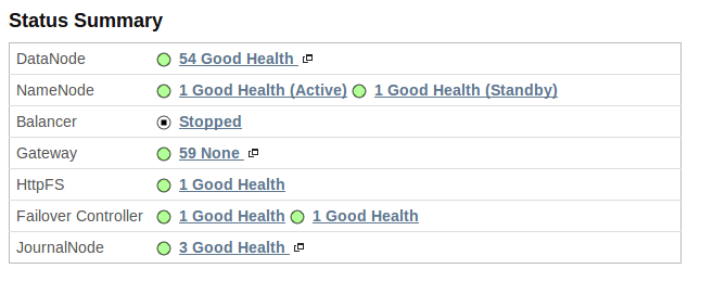

Hi, It confuses a little.
CM says that balancer is stopped:
But commands interface says it is running:
