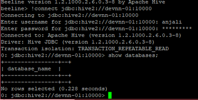

When try to open hive through beeline it connects properly to beeline-hiveserver2, but if I use any query on that then it does not give response. for ex. if I hit query show databases then give just empty list (no database is shown). Ideally it should show the list of databases present on that cluster.

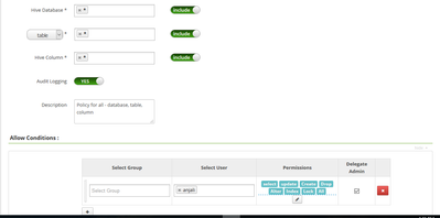

@Sindhu Yes I have a ranger policy for hive and login user has all permissions on all databases. And I have also checked on hive cli show databases its working it gives us all databases.

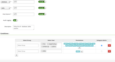

@Anjali Shevadkar
Can you share the screenshot of the Ranger policy and also, error snippet from Hiveserver2 log?

I checked internally and below policy works:
beeline> !connect jdbc:hive2://:2181,:2181,:2181/;serviceDiscoveryMode=zooKeeper;zooKeeperNamespace=hiveserver2
Connecting to jdbc:hive2://:2181,:2181,:2181/;serviceDiscoveryMode=zooKeeper;zooKeeperNamespace=hiveserver2
Enter username for jdbc:hive2://:2181,:2181,:2181/;serviceDiscoveryMode=zooKeeper;zooKeeperNamespace=hiveserver2: hive
Enter password for jdbc:hive2://:2181,:2181,:2181/;serviceDiscoveryMode=zooKeeper;zooKeeperNamespace=hiveserver2: ****
Connected to: Apache Hive (version 1.2.1000.2.6.5.0-292)
Driver: Hive JDBC (version 1.2.1000.2.6.5.0-292)
0: jdbc:hive2://xxx:> show databases;
| database_name|
| default|
| testdb |
+----------------+--+2 rows selected (0.362 seconds)
