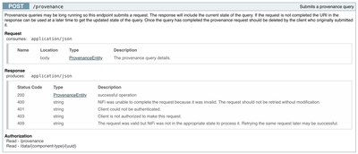

That happens because NiFi 2.x API does not work with an empty POST on for provenance, it always needs to consume a valid JSON:
https://nifi.apache.org/docs/nifi-docs/rest-api/#provenance
You need to add the query, something like this:
curl --insecure -X POST -H "Authorization: Bearer <token>" -H "Content-Type: application/json" -d "{\"provenance\":{\"request\":{\"maxResults\":1000}}}" https://localhost:8443/nifi-api/provenance
