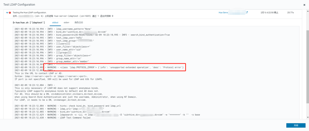

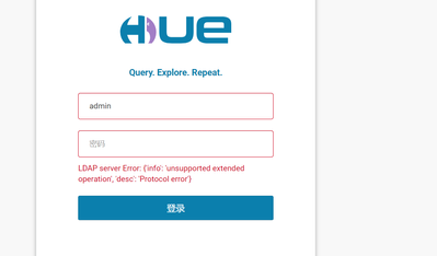

Hi,I am a big data engineer from China. I tried to use "hue ldap" in cdh6.3.2 for some configuration, but failed. I can use it correctly in cdh5.14, and I guarantee that the configuration of the two versions of hue is the same, but it can't be used in cdh6.3.2. There are few exception information, and all the exception errors are in the picture
In CDH->WEB->HUE->"Test LDAP Configuration":
In HUEweb:
I've confirmed many times that the configuration is not different
All the errors are only shown in the above two pictures

Do you see any error messages in the Hue logs?
This is usually seen due to the fact that the use_start_tls flag by default is set to true if the ldaps is not used. You may try to disable this property as below in the Hue safety valve and let us know if this resolves the issue:
• Cloudera Manager > Hue > Configuation > Search for Hue Service Advanced Configuration Snippet (Safety Valve) for hue_safety_valve.ini
• Add the below property:
[desktop]
[[ldap]]
use_start_tls=false
