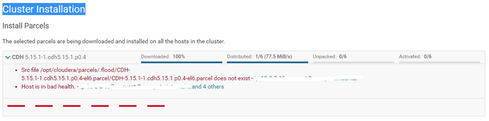

I tried to add existing hosts(datanodes) but installation stopped with below message at Cluster Installation -> Install Parcels
Src file /opt/cloudera/parcels/.flood/CDH-5.15.1-1.cdh5.15.1.p0.4-el6.parcel/CDH-5.15.1-1.cdh5.15.1.p0.4-el6.parcel does not exist

If you lost your database and then reinstalled CM, the agents will not complete the heartbeat to the new CM since the cm_guid does not match the value in CM.
To correct this, on all hosts with agents running:
- # rm /var/lib/cloudera-scm-agent/cm_guid
- # service cloudera-scm-agent restart
I think the reason you are seeing those errors in the parcels page is because the agents are in bad health... due to the cm_guid.
the cm_guid is generated by CM and the agent stores it to make sure the agent does not communicate with a CM / database that is unexpeted.  The process of removing it will allow the agent to see that it should now accept communication with the new CM server/db that you have.

Thanks a lot, this works for me.
