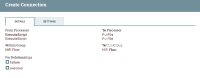

Your requirement is basically how NiFi works. When making a connection between two processors, you are asked (for processors where this is relevant) to make a SUCCESS or FAILURE connection. Thus, from one processor make a success connection to the downstream processor to be triggered on success and then make a separate failure connection to the one to respond to failures (in your case, PutEmail processor).
This works the same for connections between processors as it does for connection between process groups.
Specifically for ExecuteScript, in the script you define success and failure as follows:

@Gurpreet Singh If I am understanding the requirement correctly, you should define REL_SUCCESS in the script if you find the file, and this is connected to the processor you want to kick off. Define REL_FAILURE if the file is not found, and kickoff the processor you want for that fail condition.
For python example, see:
https://community.hortonworks.com/articles/35568/python-script-in-nifi.html https://gist.github.com/mattyb149/89205fcbc6d0e15ba024
Note the line: session.transfer(flowFile, REL_SUCCESS)

@Gurpreet Singh I updated the previous answer with links to ExecuteScript using python scripts, and the important line: session.transfer(flowFile, REL_SUCCESS)
