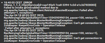

Hello, Can I connect the local Nifi also ( not on HDF ) to a remote Hbase which is on HDP ?
1-If yes, then there is no need of changing hbase.regionserver.info.bindAddress from 0.0.0.0 to ip of my HDP in hbase-site.xml and core-site.xml ?
2- I should give both core-site.xml and hbase-site.xml to the controller ?
3- I just gave hbase-site.xml and I changed the ips from 0.0.0.0 as I said to my ip in this file. I have an error with Zookeeper as bellow
I should set it as well. yes?
3- I just used hbase-site.xml and as I said I changed the ip from 0.0.0.0 in this file to my HDP ip and I get an error for my Zookeeper as below. I should set that also ?
