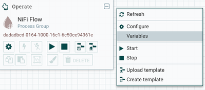

The "NiFi Flow" itself is also a process group, see on the left hand side when you log in, note the Process group ID that belongs to my NiFi Flow. I will also set a var on the NiFi Flow and retrieve it with REST:

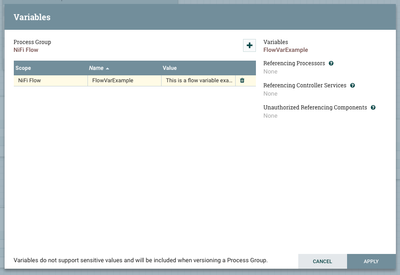

Setting a random var on it;
