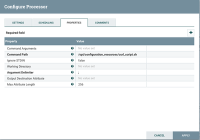

I don't have a specific link to a doc, but here is an example of what I did once using the ExecuteStreamCommand processor.
Here is a a snapshot of the configuration of the ExecuteStreamCommand processor. My particular example stops and starts the processor. Also, you can put the script anywhere the NiFi process is able to access and execute it.
Here is the script, this script had to retrieve a token, because my particular instance of NiFi was secured and used LDAP for authentication. If your instance of NiFi isn't secured then you could skip that first step and none of your curl commands will need the -H 'Authorization: Bearer'$token'' parameter. In addition, you'll have to change the processor uuid to match the uuid of the InvokeHttp processor and the URL of the NiFi instance should match yours.
