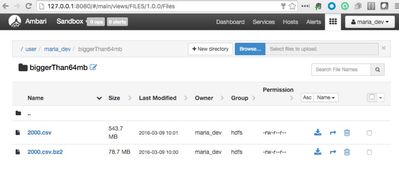

On the flipside, I did test this out a bit with the HDFS Files "Ambari View" that is available with the 2.4 Sandbox and as you can see from the screenshot, user maria_dev was able to load a 80MB file to her home directory via the web interface as well as a 500+MB file. I'm sure this Ambari View also has some upper limit.
Maybe it is time to start thinking about moving from Hue to Ambari Views??
