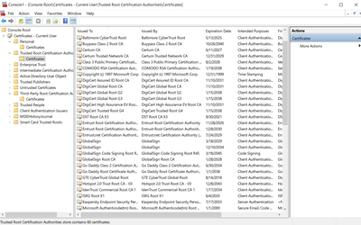

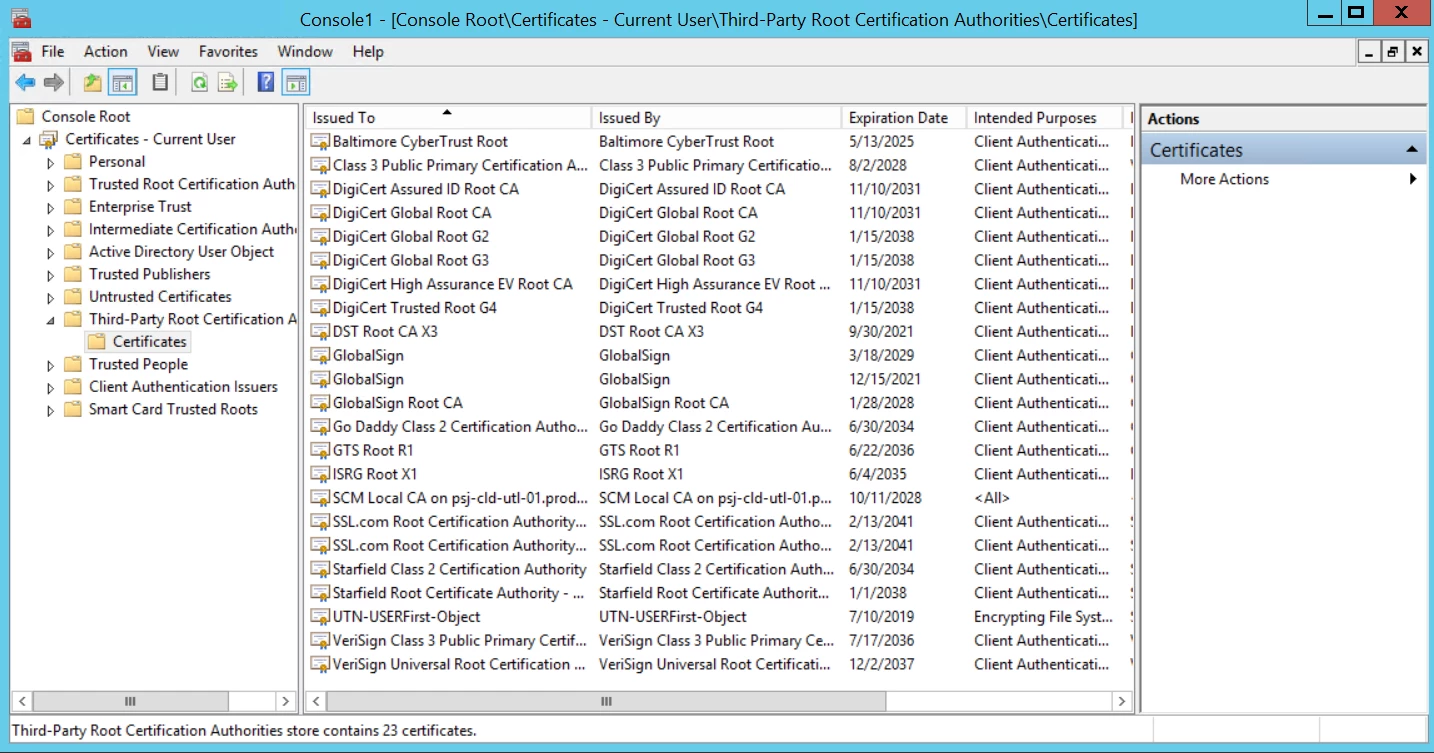

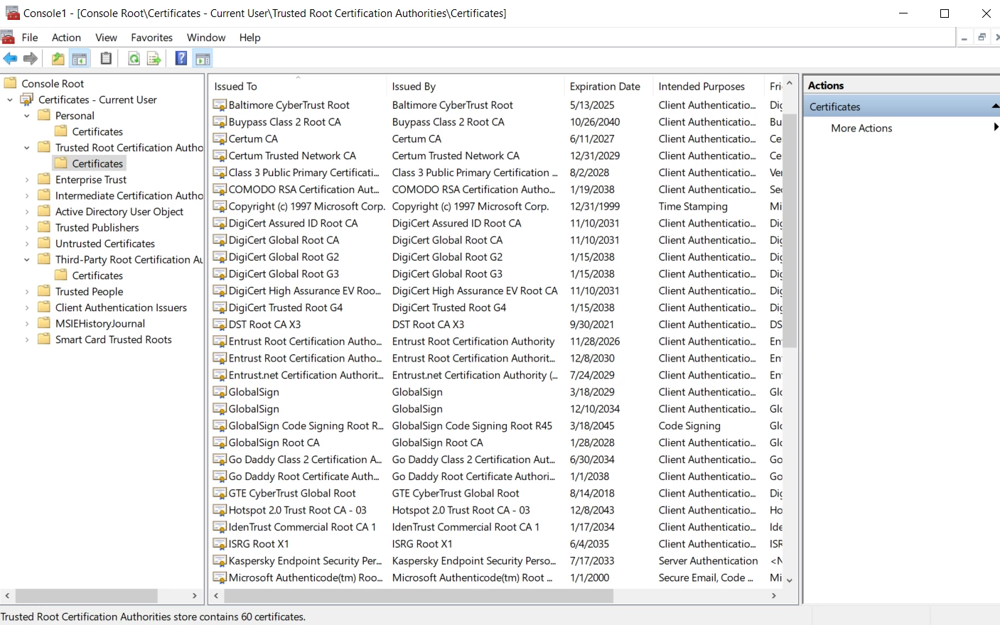

Is there any certificates that need to install in windows server? when I check in certificates console my laptop got much certificate than server
My laptop
Windows server that can't connect to Impala
