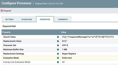

For the particular example that you shared above, this works:
The settings are:
Search Value:      (?s)(.*\"responseMessage\"\s*:\s*\"[^\"]*|\G[^\"]*)\"(?!,)
Replacement Value: $1\\"
Evaluation Mode:   Entire text
You can check it out here: https://regex101.com/r/paPPhK/1
