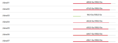

Hello everybody,
One of my disks on a datanode brake down few months ago. I changed it to a new one but my HDFS won't balance datas between disks. So, i have 7 disks with 80-90% of their capacity and 1 disk with only 15-20% of his capacity.
I tried couple things, such as balancing HDFS or delete every small files.
Furthermore, this difference between disks created a huge amount of blocks in my cluster.
(The datanode has 1,043,627 blocks. Warning threshold : 0)
Do you have any ideas to fix this ?

Hello @OscarData. Running HDFS balancer will not help to balance the disks of a data node. Balancer will only help to balance the data among multiple data nodes but to balance the disks in a particular data node, you would need to run the intra disk balancer. Please review this article on how to run it to balance the disks in a data node. Thanks!
