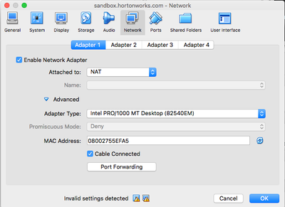

Can you check the Virtualbox network rules to see if port forwarding is properly setup? If you ssh/scp to 127.0.0.1 on port 22, that defaults to your local computer. If port forwarding is not setup to forward that port to the VM, then you will get a connection refused.
Network -> Advanced dropdown -> Port Forwarding

Hi Michael, thanks for your quick response; the port forwarding for ssh is set as host 2222 / guest 22.
Long time since I've done any work with port numbers but I'm guessing that's not correct?

No, that is correct. So you need to connect with WinSCP using port 2222. Virtualbox will forward that port to 22 on the VM.
