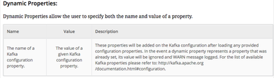

The ConsumeKafka_0_10 processor allows dynamic properties:
You can try adding a new dynamic property to your ConsumeKafka_0_10 processor for "max.message.bytes" with a value of 2147483647 to see if that works for you.

The ConsumeKafka processor will only accept dynamic properties for Kafka consumers only.
max.message.bytes is a server configuration property.
I believe what you are really looking for on the consumer side is:
max.partition.fetch.bytes
This property will be accepted by the consumeKafka processor and you will not see the "Must be a known configuration parameter for this Kafka client" invalid tooltip notification.
