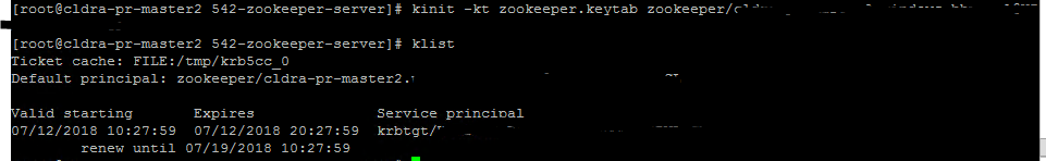

Successful kinit with zookeeper.keytab:
Error on Zookeeper:
Unexpected exception, exiting abnormally
java.io.IOException: Could not configure server because SASL configuration did not allow the  ZooKeeper server to authenticate itself properly: javax.security.auth.login.LoginException: No password provided

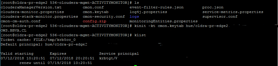

Successful kinit with cmon.keytab:
Error on starting Activity Monitor:
Failed to start Firehose

Caused by: javax.security.auth.login.LoginException: Unable to obtain password from user
