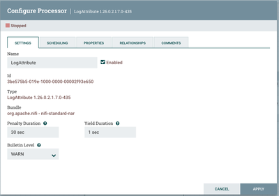

For example, I did some starts and stops for this processor.
By checking the log using the ID, I found this:

hello in the logs above I don't see any log which describes LogAttribute (the screenshot you have posted above says it is a LogAttribute processor) being started or stopped. Also anyway to know which user did this
