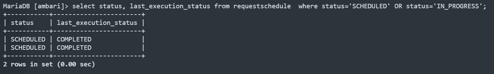

@enirys This issue occurs when the request status in Ambari DB is not matching the current status of LLAP. Due to this, we can't enable Interactive Query.
1) Kindly check for the status in the Ambari DB using the below command:
"select status, last_execution_status from requestschedule
where status='SCHEDULED' OR status='IN_PROGRESS'"
2) To change this, run the following and change status form requestschedule table to 'COMPLETED'.
update requestschedule set status='COMPLETED' where status='SCHEDULED'

Thank you for your reply, you are right about ambari DB. i had two requests in "SCHEDULED" status.
I just updated the status to "COMPLETED" then restart ambari to get it working.
